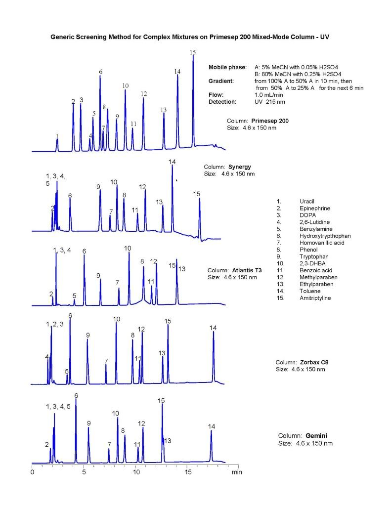

here is an example of low pH screening method for 15 compounds of different nature. Relative comparison for C18 columns, please note low retention for group of hydrophilic ionic compounds

This is a nice comparison, but I am not sure that it is a correct one. In your experiment bids are only different in color. In chromatography analytes are different by several parameters (hydrophobicity, polarity, ionic properties, etc). The correct experiment would be to mix colored bids with other shaped colored objects. So even in your case you can separate them by shape and color using simple mesh (after you separate them by color) or just spreading them on a flat surface. Chromatography is science of selectivity.
My point at the presentation was to show people what 0.03 % or lower looked like. I thought that using the objects of the same size and shape but different colors to represent the different types of chemical compounds did that. Besides, you could find a large enough bead where only a few would be needed to make up the bulk which would make the separation issue seem fairly simple, which was not my point.

Ha Vlad, the mine is better than yours commercial picture.
can you say if the application was done on all columns the same way before i comment?
thank you
If your separation is better then it is good for you and your company. Did you really run the same mixture :) Fair question is how long it took you to get a better separation and how many columns you have screened to do that - basically how much it cost your company to develop a method.
Same conditions of mobile phase for experiments, different days and different Agilent 1100 systems, also we had to do some blank subtraction due to high background on one of the columns, but to be fair the column was pretty old. The goal was to develop a generic screening method for walk-in labs for complex/not-so-complex mixtures.

so if you have started from 100% buffer and not with 5% ACN, and made another gradient profile, it is very probable that another column would have worked as well from those that are shown here, hence i call the picture "my column is better than yours"

We tried starting from 5% ACN and it did not change anything, we even started from 0% and some of the phases had a phase collapse. It was worse chromatography for RP column when we started with lower ACN, and there were still no separation for first 3-5 compounds.

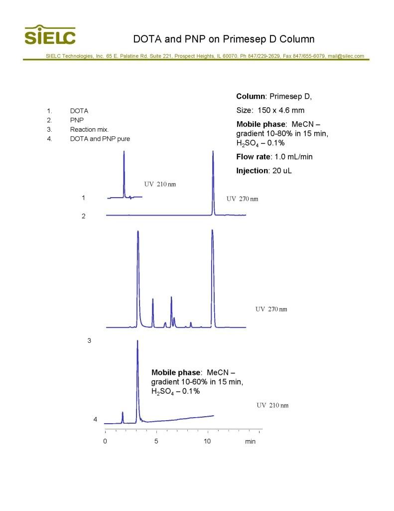

2. I think that complex of DOTA and Gd is not going to survive in HPLC and you might need to look at DOTA and Gd (3+) separately and then do calculations. We already have method for DOTA and I can send it to you if you send me inquiry through our website. Send me email and we can discuss how to tackle this issue.
I welcome you to try RP for DOTA, my guess your peak shape is going to be ugly.

here is method for DOTA-PNP. We had slightly different task - to separate DOTA and DOTA-PNP

as for the mine is better than yours pictures shows columns that we have used without problems with 100% buffer for a few minutes and then moved into a gradient of organic. but maybe your columns are sensitive. i have to admit i kind of think the 5% acn make the other columns look bad.
