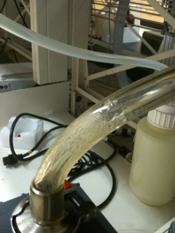

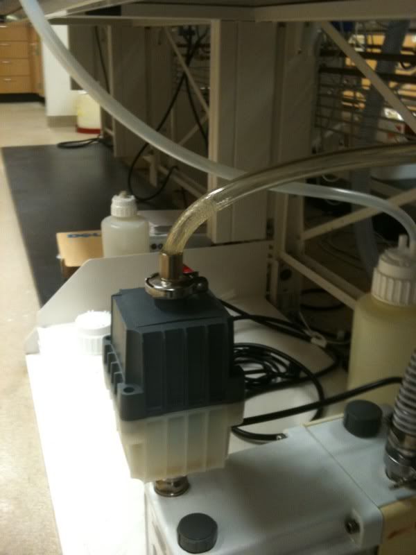

I have an issue with the rough pump oil backing up above the mist filter in my Edwards rough pump. See pictures below. I tried opening the ballast, but this did not solve the problem. Any idea what caused this and how to fix the problem (preferably, without venting the instrument)?

does your pump actually have a two-stage ballast valve with oil-return system, or is it just a normal ballast valve and a mist filter that needs emptying manually?
The mist filter automatically empties when the ballast is open. It's only a problem for this oil trapped in the vent line above it.

How you got oil up there I don't know, but disconnecting the tube and cleaning it will not harm your MS (just don't do this when you are running any solvents).
As noted by lhm, you should have a small black tube from the mist filter that goes back to the pump.
We had the same problem some weeks ago. I cannot give you many details about its cause ( I'm no engineer) but I believe it's due to a leak of the oil indide the pump, probably through a faulty seal.
It should not be dangerous to your MS but be aware that you are expelling oil mist through that tube and there is the risk of running out of oil in the pump, which would cause a major damage.

If you pump enough oil into a mist filter that it overfills and starts to bubble up into the tube, it's not necessarily fatal. Clean out the tube and empty the mist filter, and remember to open the 2-stage ballast valve a little earlier next time! I've done it (once!), and our MSD survived.
