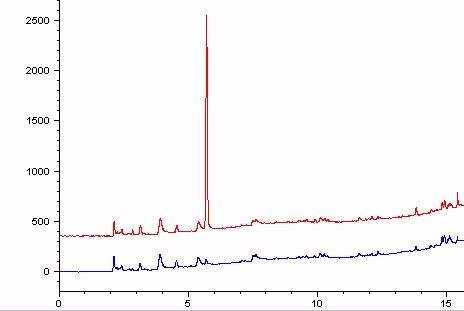

I was curious about the ethanol part so I did a quick experiment. I added 1.4 µL of 190 proof ethanol (density is 0.789 g/mL) to 100 mL of water and ran it with my "starting point" SPME method. I was able to see EtOH with a flame detector at 10.5 ppm.
The S/N ratio for that response is 294. If you take the LOQ as the concentration where the S/N ratio is 10, then I can quantitate EtOH at 0.4 ppm. Likewise if the LOD is the concentration that gives a response where the S/N ratio is 3, then the LOD is 0.1 ppm. Not bad for something so water soluble. The split ratio used here is 5:1. I could improve the detection limit if I didn't split the injection as dramatically.
The peak at 5.6 minutes is ethanol. The blue trace is the water blank used to make the standard.
SPME Conditions: Carboxen/PDMS/DVB-2cm, 60 °C preheat for 15 min., followed by 30 minutes headspace sampling at 60 °C. I used a dry-bath heater for this work.
